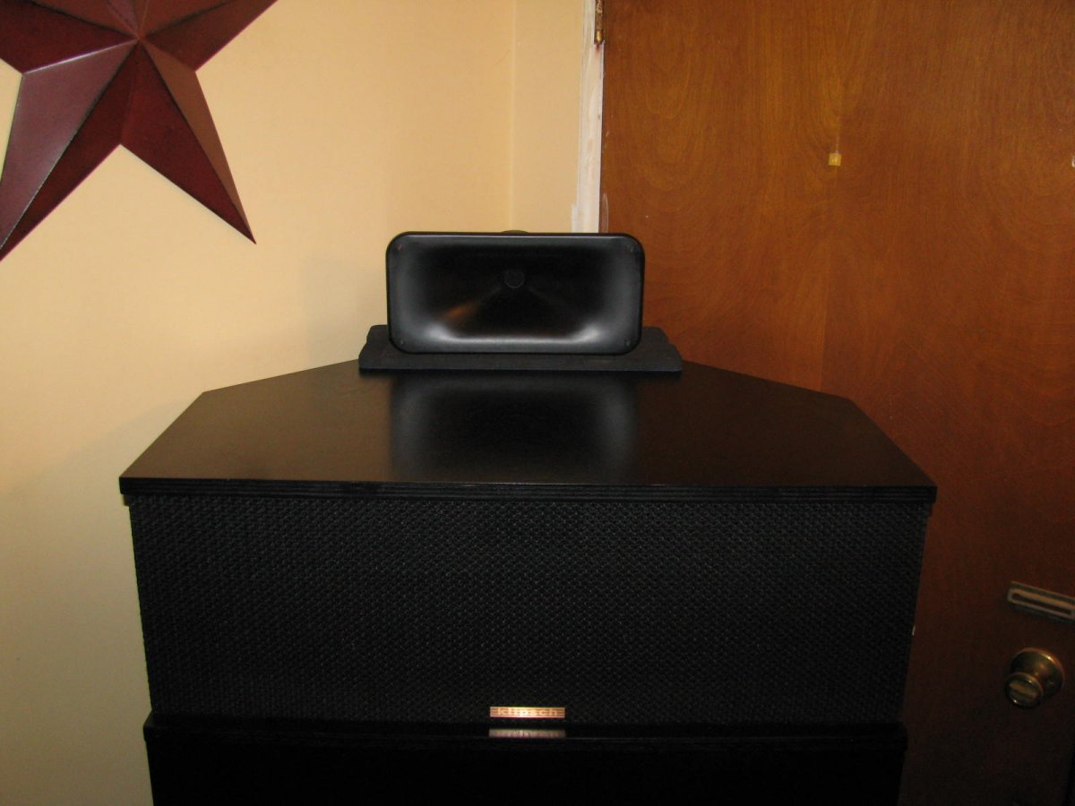

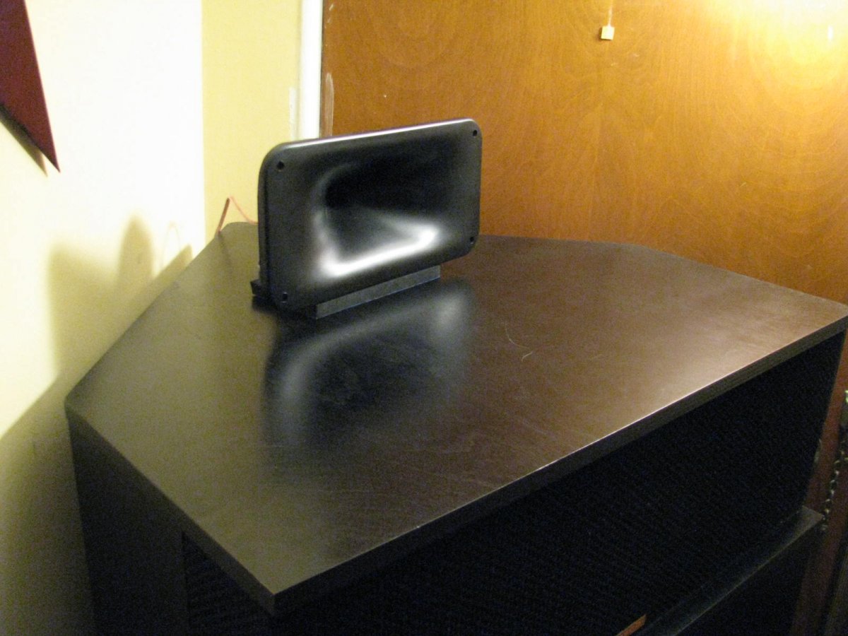

    How about putting a SEOS 12 w/DNA-360 on top of a Khorn?
    It has a LOT more acoustic energy than the stock K-77. The sound is tremendous, very dynamic. It almost sounds like another mid-range when used with the Crites A-4500 XO, which crosses from the mids at 4500 Hz instead of the stock 6000 Hz.
    You can see by the way I have it set back to align the mid and tweeter CD's. It takes care of some the time-alignment delay problems inherent to Khorns.Khorn right SEOS front.JPGKhorn SEOS right top view.JPG

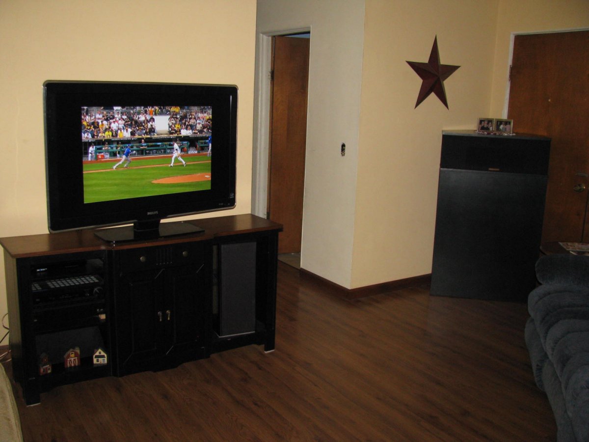

    This shows the location of the Khorn in my living room w/pics of the kids instead of the SEOS. The pics of the kids had to go to make room for the SEOS. You've got to have priorities.
