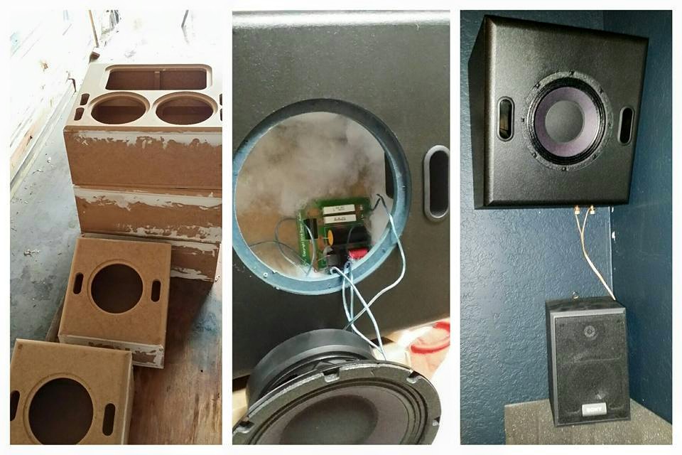

    I've had my DIY Sound Group kits in my signature powered up for about a year now. This was my first speaker build and Eric was extremely informative and quick to answer my questions. Partnered with the Epson and 120" screen we have become the neighborhood "hot spot". Not a weekend goes by without movie night shared with family and friends.
    I have to say that when I moved up from the "mainstream" brand of HT speakers which consisted of tower fronts and surround rear I was skeptical if I would notice a difference. Man was I wrong. Voice clarity and sound effects are outstanding. We also empty the room which is blacked out and have "club" night. These speakers deliver in all genres.
