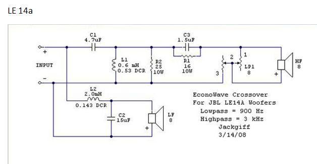

    My plan is to buy a pair 360 together with a pair SEOS12 to coup with. Actually I have been to AK forum and know that Jack designed a crossover specially for the LE14a n for the public to share. I could copy and post that here if permitted.

  6. http://www.audiokarma.org/forums/attachment.php?attachmentid=151339&stc=1&d=1243017683
    They said anything JBL/ PYLE PH612/Dayton H6512 will work.

  8. Sorry, I thought it'll go direct to the page once U click on. Here comes the crossover.

  9. That should get you in the neighborhood. And it's got an lpad so you can adjust for sensitivity if you need. If you build it, let us know how it goes :)
  10. Does it mean the green light is on :) AK members warn me the wave-lenght of the SEOS12 waveguide might not match with all those being originally used, the JBL/Plye/Dayton ones.

  12. The AK guys aren't wrong. If the horn depths are different, then the cross over may need to change. Depends how much of a difference it is. The SEOS is pretty shallow. The SEOS may change the shape of the response a little as well. If we didn't have a ferry between us I'd say come over and we'll measure it and develope a custom cross over. The AK cross over is probably in the neighbourhood, but I wouldn't say it's perfect. You could try the SEOS and probably resell them in Canada very easy if it didn't work out. But then your cutout might be wrong for the right horn. If you're not up for experimentation, you should either send the woofer to me for a SEOS cross over, or get the right horn.

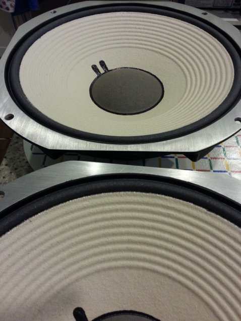

  15. Before I go on with anything, I thought I have to deal with the broken surround of my 14a first. I have them moved out from my storage and found both surround were broken.
    I need some advice here. The guy who repaired the surround last time put the foam underneath the cone. You can check it from the picture with the broken surround. I have them cleaned up and wait for the rescue from Rick. I've been seeing guys putting the foam on top of the cone. Should I simply put them on top ?

  16. I put them on top of my 2245h. A lot easier, looked fine, and I can't imagine any significant performance issue.
  17. Thanks n I'll put it on the front.

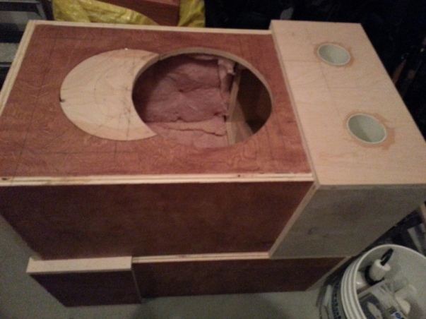

    The 3.5 cu.ft. boxes are coming along. My plan is to tune at 32hz with 2x 3" pipe at 8.75"L . Is the box capable doing that good ? or I should go with other number?
  18. I tried dry-fit the foam surround on top of the cone but didn't fit well into place. I therefore put them back to wherever they supposed to be - at the back of the cone. They sit there very well almost 100% fit. It took me almost 5 hrs to have them finished yesterday n they are singing for me now but with no box. :)

  19. I had the box resized to 4.35 cu. ft at the weekend. They will be around 4 cu. ft with all drivers n padding on. 2 ports 2x 3" x7"L tune to 32hz if my math is correct. Please advise.

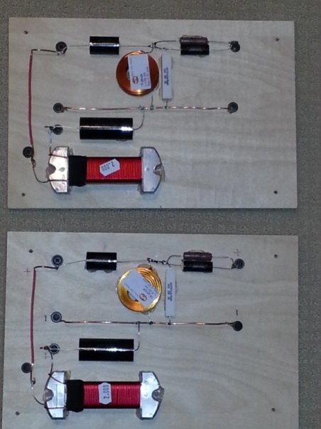

  20. The 2 crossover are done too. I patiently waiting for the waveguide/ 360 drivers to come, so I could cut the hole and put them to run.
  21. Nice neat job on the crossover. The LE14's look nice too.
  22. Coming along nicely! Keep the pics coming 8)

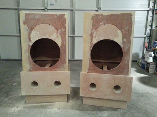

  25. I have the boxes ready for paint. Still have to wait for the waveguide for the hole size. Luckily Erich has them sent by today. :)
    See if I can finish them in couple weeks.
