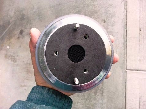

    See how big is the 360 if compares with my little hand. I thought I have to finish the box asap.
    I know the 360/350 size the same n there is no nothing on the driver to tell. Is there any significant features to tell which is which?
  3. tuxedocivic
    tuxedocivic Well-Known Member
    May 24, 2012
    413
    Ladysmith, BC
    The 360 has gold plated binding posts iirc. The 350 are just metal.

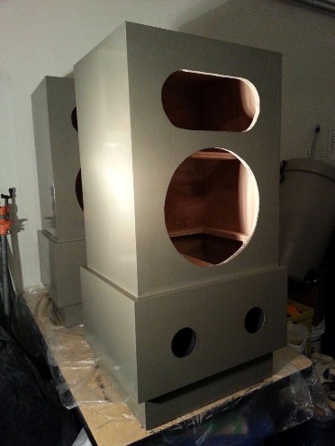

    Paint job is done. Hope I have time to put padding on tomorrow.

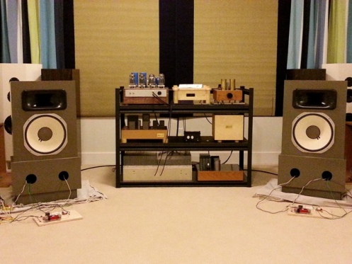

    Ryan, Bill & all knowledgeable souls,
    I have my ewave fired up last night for couple hours. It sounded good. The bass n mid bass outline a lot of details with authority. The mids are smooth, rich and admirable. All sorts of vocals sound very real. Piano is on it's size and weight. Violin is so smooth n rich, I love it, love it. The highs are also very smooth n too smooth that I can't hear too clearly there is a triangle n the cymbal, as if the musician are playing at the backstage. Could it be the problem with the Dayton 5.6uf cap, or I have to tweak the crossover ?? Lpad was set at 1 o'clock.
    I've picked the deluxe crossover that I posted at Feb.23 ( high pass- 5.6uf series 4R7, 1mH parallel 2R7 to ground ). Could U kindly give some advice for me to try. I'd really appreciate & would try anything suggested.
    Thanks in advance
    Albert

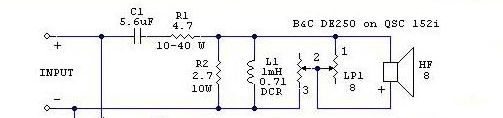

    The following is the crossover I copy from other forum of which Zilch designed as deluxe version for 3012LF.
    Thanks
    Albert

  14. BillWaslo
    BillWaslo Well-Known Member
    Mar 17, 2012
    367
    Portland OR
    Alberti, are you sure that crossover is right? There doesn't appear to be any Constant Directivity (CD) compensation in that circuit, as if it were for an exponential horn rather than a CD type. There should be (usually) a series resistor (10 ohms or so) paralleled by a small capacitor (1uF or so) ahead of the pad to bring up the high treble relative to the low treble - as in the usual Parham/JackGiff Ewave crossover. Or another way to do it is with a small inductor (0.15mH or so, with about a 1 ohm series resistor) in parallel with the tweeter.
    I can see why the highs would droop way down with that crossover.

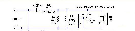

    which is the R1 series 4.7 ohm resistor in this photo?

    The drawing is what I am using but not the photo one.
