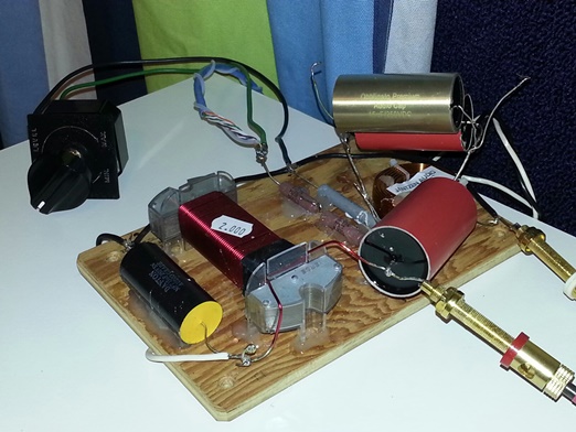

  2. I assume the photo is the LE14 variant of the econowave crossover. Did you try listening to it?
  3. Don,
    I have them put together for photo but didn't try on those. I switched to try the deluxe instead. Thanks for reminding me. I should try this the first place.
    Albert
  4. Oh...... sorry to tell that I have tried different crossovers over the last week, none of the crossover meet my expectation. Since I have another 3 pairs speakers to compare, a pair of full-range Alpair12 on pencil, PMS & OB with 1858.
    I thought I have to reconsider my approach, either copy a proven design & sell the 14a, or........Mmmm any suggestion.

  11. I put up a crossover and have them played for almost 3 hours. They sound pretty good with lots of bass, deep kick ass bass. Mids n highs are also fine. I thought they would be better if I feed them with some good capacitors that I have in hand.
  12. This is the crossover I have been playing around with the last couple of days. I have found the better the caps, the better the sound to my ears.
