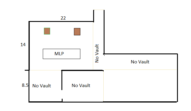

    The system (speakers and PC/TV) is in the family room, approximately 19' x 14' with vaulted ceiling along the long axis running from 8.5' to perhaps 15'. The 14' left wall is all glass. This space is open to a living room with approximately the same size and mirrored vaulted ceiling, a hallway, and 2 other rooms. It's hard to describe. I drew a rough diagram, but the forum software thinks it's spam.

  2. Diagram attempt:
