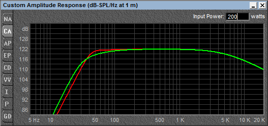

SEOS 18, AE TD15M, Denovo BA-750, active crossover, distributed subs --(2) group buy Anarchy 6" folded horns, (1) 12" sealed. First I'm going to build boxes for my pair of TD15M's. I like the idea of having bass bins with the CD/waveguide assemblies either having separate simple boxes or hardwood brackets to hold them in place. This way I'll have flexibility in case I want to try other waveguides. I'd like to have the F3 fairly low so I'll need to have a vented box and apply equalization. Presently, I'm using WinISD beta. I found winISD Pro full of bugs. I entered the TD15M parameters and specified a tuning frequency of 35Hz. Since the Fs is 34.7, the drivers should be able to handle 35Hz. However, the graph said that it'll be down 7db @35Hz. Is this too much to equalize? I decided to model 40hz. I do like the 35Hz because it would make the woofers closer to subs therefore work well with my subs. ------------------------------------ Here's the graph for four different boxes. The F3 65Hz box has a 5db bump around 80Hz. The 35hz box is down 7db at tuning freq.The sealed and vented (40Hz) boxes seem to display smoother responses so are they should be more optimum. Am I reading this right? I'm a newbie when it comes to speaker design and this is the first time I've worked with winISD or used active equalization. How far can I push the woofer to change the response? I'm using the basic program, not the beta pro version which I found buggy. Could I push a sealed box design lower (~40hz) with equalization and without affecting sound quality? It would be ideal if I could use a sealed box thereby avoiding huge and expensive bass bins. Here are four boxes I modeled. yellow-- sealed box: W: 18.00 in., H 19.36in., D 12.00in 2.42cu. ft. F3~75Hz blue--vented box: W 18.00 H 30.00in, D 19.20in 6.00cu. ft. F3 65Hz (1) 6"vent green--vented box: W 18.00 H 30.00 D 19.20 6.00cu. ft. F3 40Hz (2) 4"vents orange--vented box W 18.00 H 30.00 D 19.20 6.00cu. ft. F3 35Hz (2) 4" vents From the look of the numbers I think I'll go with the 40hz box. Of course, I'd prefer a smaller box but going sealed would sacrifice much of the capability of the TD15M. In conclusion, the 40hz vented box is the best compromise. Unless I get feedback that I'm all wet or a better sealed option is possible ....40hz vented is it for me unless I change my mind again. : You can drive yourself batty modeling all the possibilities. This will be for 95% music 5% HT.

Given that box height, I would be looking at: Center of the driver is about 7.5 to 8 inches from the internal top of the cabinet (basically, as far up as you can mount it!) A box with internal dimensions around 30 inch tall x 19 inch wide x 17 inch deep (changing the width and depth while keeping the same internal volume shouldn't pose a problem. I just assumed that with an 18" WG, a 19" width would work. If you want deeper and less wide that should be fine - I can make a quick adjustment) Center of the port about 25 inches from the internal top of the cabinet. 3.7 lb of stuffing in the first 15 inches from the top of the enclosure 234 cm^2 of port cross section area x 10 inch long port In my opinion this will yield an optimal tuning at about 31hz. Max SPL would be something like 20 hz - 95 db (xmax limited) 25 hz - 108 db (xmax limited) 30 hz - 112 db (port limited) 50 hz- 118 db (xmax limited) 65 hz - 120 db (xmax limited) 80 hz - 123 db (xmax/thermal handling limited) as long as you equalize it so that at your listening levels you're not exceeding these values by much, you'll be good to go. I really doubt you'll need EQ boost once you put this speaker into a real room, though. I'd be more focused on EQ cuts on room modes.
