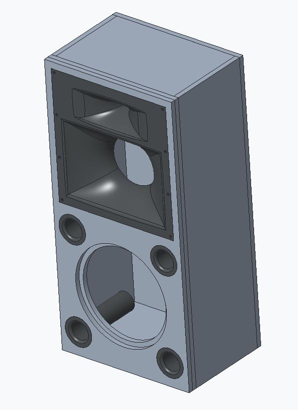

  1. Yeah that looks perfectly fine, though at the frequencies the woofer is playing being partially blocked by the frame will do very little anyway.
    3" between the crossovers should be plenty of room, the only thing you don't want is to place them in some way where you end up lining up the axis or core of two of the inductors so they point directly through one another, 90 degrees or an offset of several inches among those that point the same direction is fine.
    The crossover was split into two boards to allow greater flexibility in placement and potential future designs.

  4. The Titan-815LX with 815 Standard 4.0 cu ft flat pack dimensions are perfect for my needs. I'll take three please.
  5. As luck would have it, I was able to order three Titan-815LX kits with standard flat packs, and four HT-8 kits this morning.
