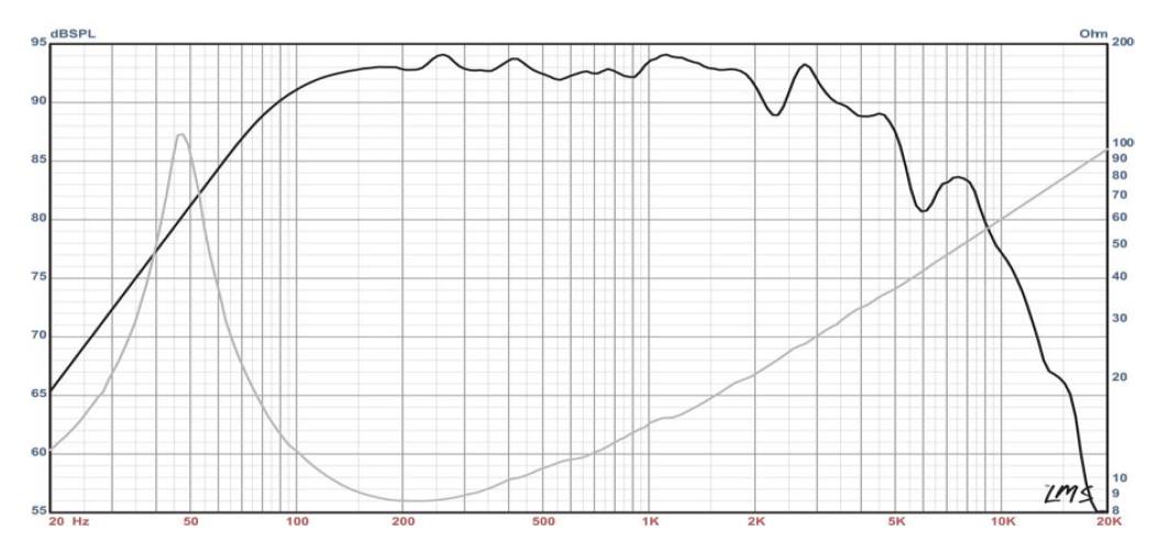

Thanks for the info. "Tannoy-like" sounds very promising. I like Tannoy. What about the EOS waveguides? I just saw Matt's Karma-8 with EOS-8, using DNA-150 w/ EOS-8. High-pass crossover is just a 1.5uF cap with L-pad. I love the idea of that simplicity (and the price is right!). It looks like the xover is at 1.9kHz or 2kHz. I think that's within the capabilities of the Eminence B102 woofers I have. http://www.eminence.com/pdf/Legend_B102.pdf (B102 freq resp curve and impedance curve are attached) I would sub a 50-watt L-pad for the resistors Matt used on the DNA-150/EOS-8. Would this give me a pretty good taste of what a waveguide/CD combo can do, or is the DNA-360/SEOS-12 combo vastly better/smoother sounding? [SIZE=small]My interest in horn-loaded speakers is for their ability to play well at moderate levels with few watts. [/SIZE]Power handling and high SPL are not my concern. I'm in a 12' x 24' room filled with furniture, records and miscellaneous clutter. I sit with my head about 6.5' from the speakers. I lean in about a foot or so when I'm seriously listening, as that eliminates some nasty room modes. So call it 5' from the speakers. As mentioned before, my PP-2A3 amp makes only 6W/ch, no global NFB loop (fairly high output resistance, but not as high as a single-ended triode amp). In the image below, Matt posted the System Impedance of the Karma-8/EOS-8 system (lower right). It looks like there's a huge impedance peak (way over 40 ohms) centered on 3.5kHz. Is that a combination of LP and HP crossing? Or is that the woofer's steep LP doing that? I think that would be a problem for my little tube amp. In these KG4.5 cabs, it looks like my choices are either 1) wait for SEOS-10, or get 2) EOS-8, 3) EOS-10, or 4) DW-774S. In all cases, I guess I'd start with the little DNA-150. Would SEOS-10 be the hands-down winner out of this group? [SIZE=small] -=|=- [/SIZE]
