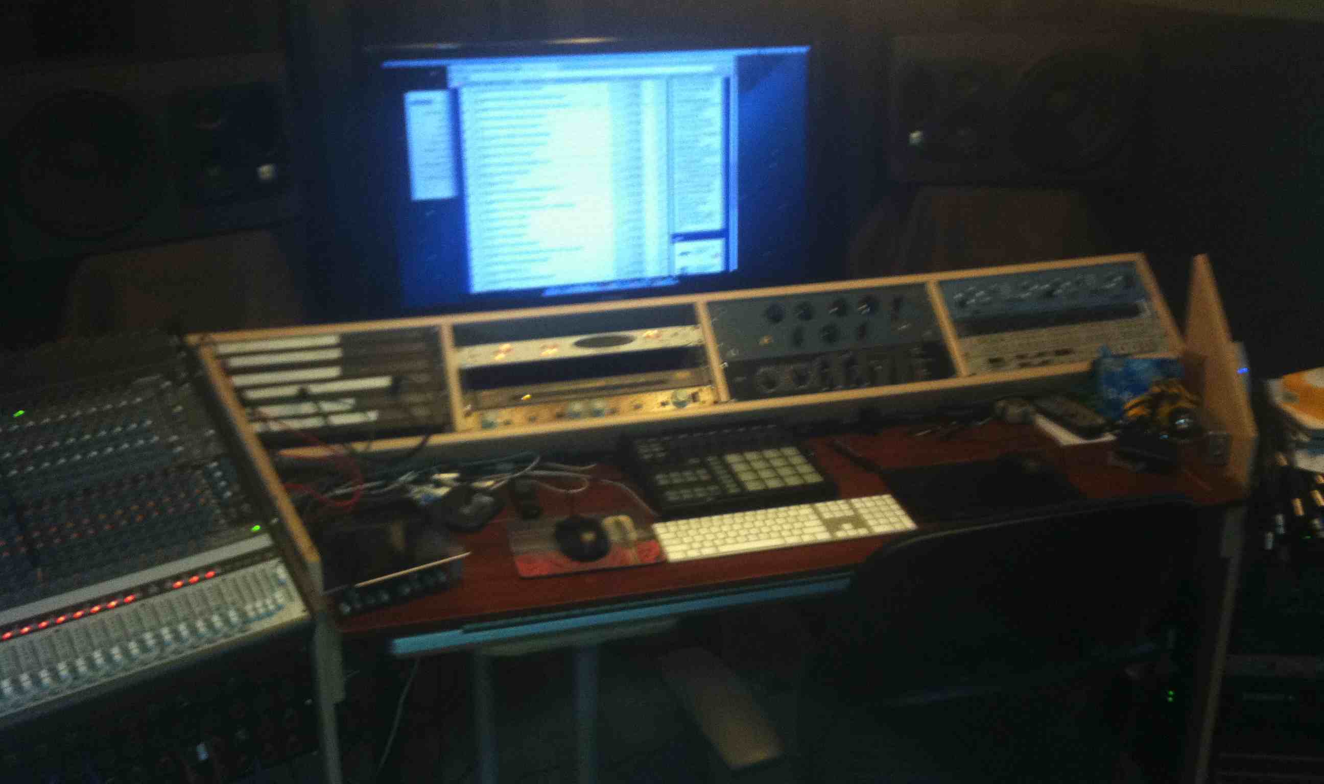

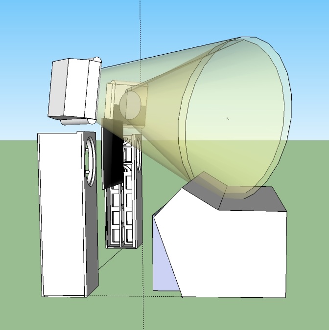

    Also here is this. The desk is close to the dimensions it will be (not a mixing console, it's a desk with rack gear in it), I plan to lower the angled part a little when I re-work it. This is why I was thinking that if the vertical nulls can be tightened in a little bit, it would probably be a good thing to help avoid diffraction coming off the desk. The boxes in this pic would be big enough to hold seos 18 + 8's.
    I'll upload some real pictures also, thanks again.
  9. ryanC
    ryanC Just joined the party
    Nov 3, 2012
    36
    Here is a pic of the desk-
    I don't have a good camera, but it gives the general scale.

    the null won't really help with diffraction off the desk, it is only within a relatively narrow band around crossover.
  11. ryanC
    Nov 3, 2012
    36
    Ok that makes sense, sorry I get the general concepts but don't have a lot of experience with all the details of them.
    But the narrow-ish vertical directivity of the SEOS would be good right?
  12. BillWaslo
    BillWaslo Well-Known Member
    Mar 17, 2012
    367
    Portland OR
    yes, that is broadband.
