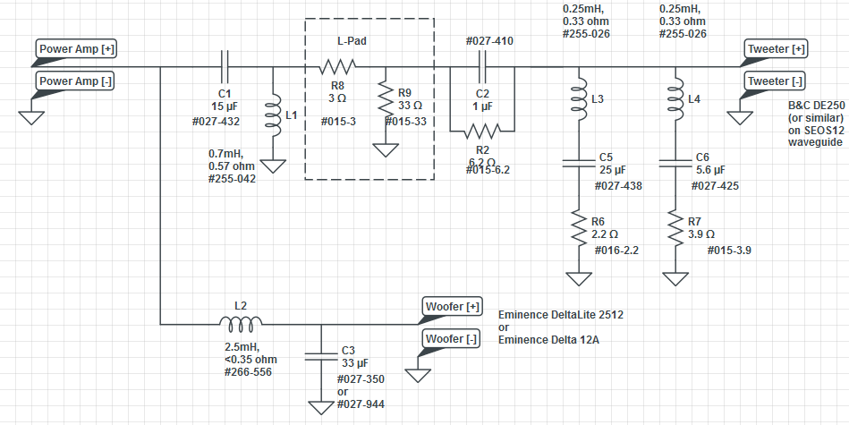

    The picture links in the OP are broken. Is there any chance to get them back?
    I am getting a good deal on the Eminense Delta 12A and I would like to build a pair of these...
  9. Matt Grant
    834
    240
    I think I have the original schematic saved here, hope it helps those looking for that. Unfortunately I don't have any of the other photos or graphs.
